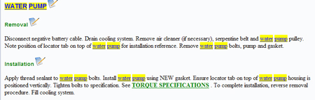

Water pump look fairly easy on this one...
https://www.2carpros.com/forum/automotive_pictures/62217_94WP_1.jpg
