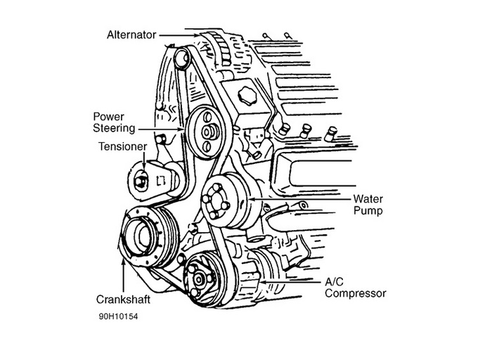

how hard is it to chage a belt and do you have a diagram showing pattern of belt
Jul 28, 2020 at 6:12 AM (Merged)
MMPRINCE4000
  • 8,548 POSTS
2.2 engine:
https://images.2carpros.com/forum/automotive_pictures/108325_belt_22_1.jpg

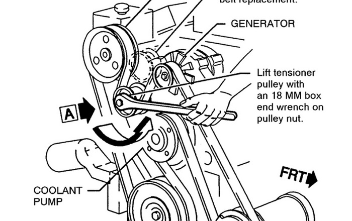

I am trying to replace the serpentine belt on my 92 pontiac grand am and I am having trouble figuring out how to release the tension on the belt I've been looking around cant seem to find anything specific I have an Idler but no tensioner is the idler the tensioner or is there something I'm missing all together
JDL
  • 16,098 POSTS
The belt routing is for a 3.1L ENGINE. Do you see the square cut-out in the tensioner, you use a rachet drive or breakover, the same size as the cut-out, pull ccw.

JDL
  • 16,098 POSTS
OK, what's the liter size of engine? The picture I gave is what our database showed. The databases are not always correct. I'll keep looking.
If no tensioner, then some of the accessories that run off the belt, have an adjustment slot, you loosen the nut or bolt and move the accessory to get slack in the belt.
JDL
  • 16,098 POSTS
I found this for the 3.3L engine.

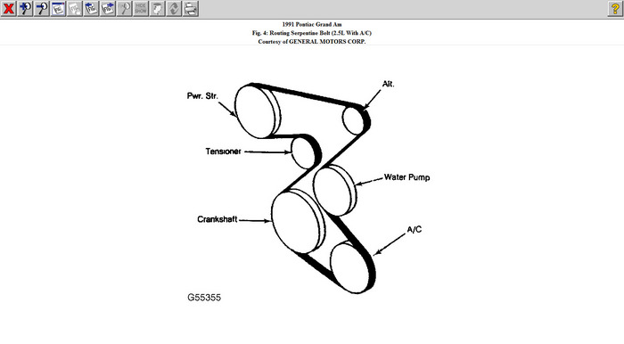

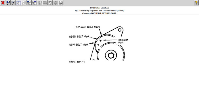

Looking at my engine I have two belts, the one large belt connecting the Waterpump and Power Steering pumps and the smaller belt connecting from the waterpump to the alternator. Both belts squeal starting from the large belt that then stops transfering over smaller serpentine belt. The belts are new and I think they've just stretched a bit(under 9 months old) I've checked with a straight ruler and everything is aligned nicely. I've figured out how to tighten the alternators belt but the large waterpump/power steering belt I can't figure out. From examining the setup it looks as if the Powersteering pump needs to be adjusted to make the belt tight. I found one bolt that was loose that appears to be where it's tightened to hold it in the new position but I can't make the pump move in any direction. Is their another bolt that needs to be loosened? Their is one bolt almost opposite the adjusting bolt but it's hidden behind the pulley and I can't see how it would be used to tighten the pump as the belt and pulley would need to be removed to gain access there isn't even holes through the pulley to access it. A picture would be great. The car is a 1991 pontiac grand am LE 2.5L
Jul 28, 2020 at 6:13 AM (Merged)
HMAC300
  • 48,601 POSTS
i'll send a belt diagram along one shows the routing,which only shows one beltand the other shows the belt wear indicators on teh tensioner. that is what adjusts the belts.
HMAC300
  • 48,601 POSTS
oops hit the wrongbutton here they are
JARED575
  • 10 POSTS
Thanks, However, not sure why this is he official picture. My car is like it says 1991 pontiac grand am 2.5l LE however it uses 3 seperate belts and has no tensioner pulley. One large belt wraps around the crankshaft and travels up to the power steering and then over to the water pump. A second belt attaches also to the crankshaft and travels over to the A/C. A third belt attaches also to the waterpump and travels up to the alternator. None of the 3 belts have tensioner pulley. All the belts are adjusted by moving the A.C pump, the power steering pump and the alternator pumps to make their respective belts tighter/looser. However I am unable to make any of the respective devices move. I must be not seeing a bolt or something.
