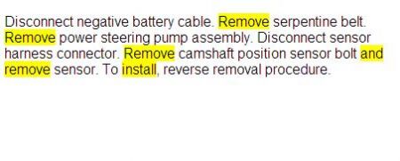

How do replace an cam senor and where is it located at?

Hi, my info says it is located behind the alternator.
https://images.2carpros.com/forum/automotive_pictures/170934_camshaft_position_sensor_1.jpg
