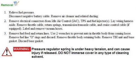

I need to know how to replace the fuel pressure regulator on the throdle body type fuel injection system in this old pontiac

Sorry, my mistake. That was for wrong fuel system..here is the correct procedures for your TBI system. You will have to remove the throttle body cover, the regulator and body cover are serviced together only.
https://www.2carpros.com/forum/automotive_pictures/261618_Noname_547.jpg
https://www.2carpros.com/forum/automotive_pictures/261618_Noname2_138.jpg
