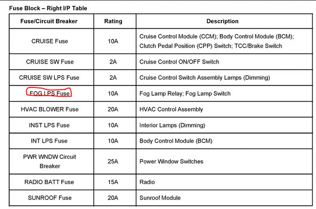

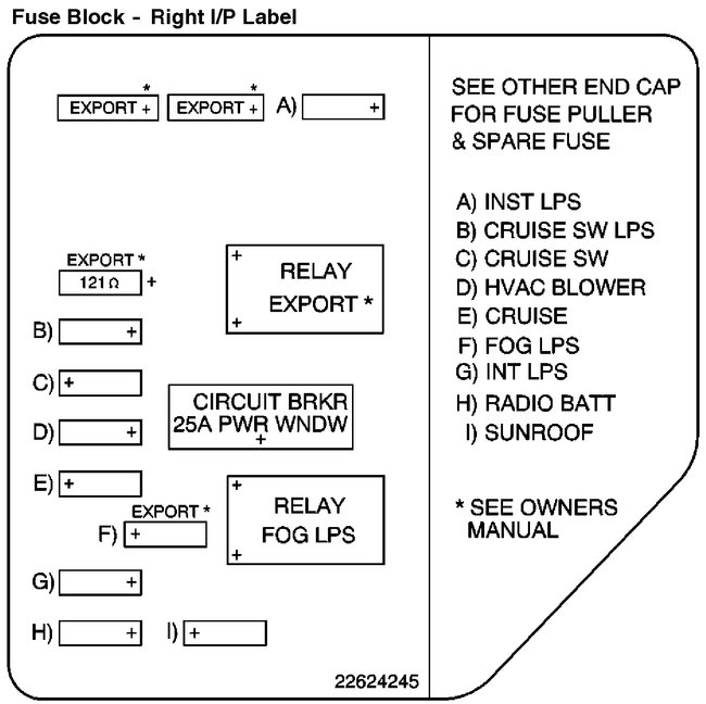

Where is the fuse for the fog lights on a, 2003 Pontiac grand am?
Jun 5, 2020 at 11:51 AM
  • 110,244 POSTS
The fuse is in the right hand instrument panel fuse box. See the pics below.
