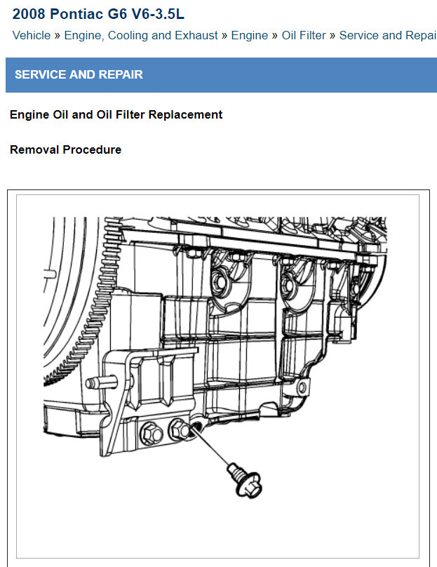

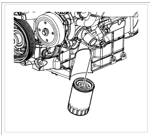

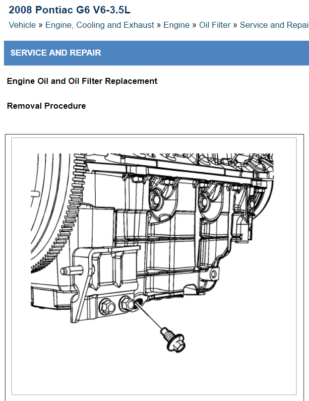

trying to change oil where do i find the oil filter on the v6 3.5L?
Jun 2, 2009 at 8:46 PM
  • 110,194 POSTS
The oil filter is located at the front of the engine on the drivers side here is a guide to help you see what you are in for when doing the job and diagrams below to show you the filter location.
https://www.2carpros.com/articles/how-to-change-engine-oil-and-filter
