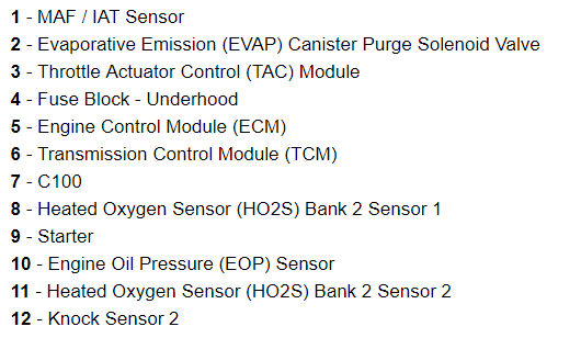

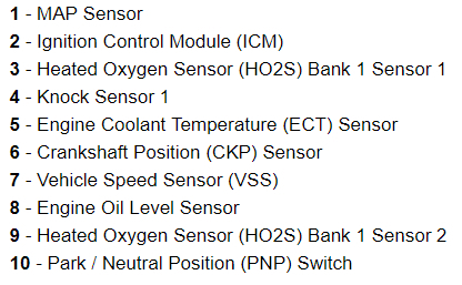

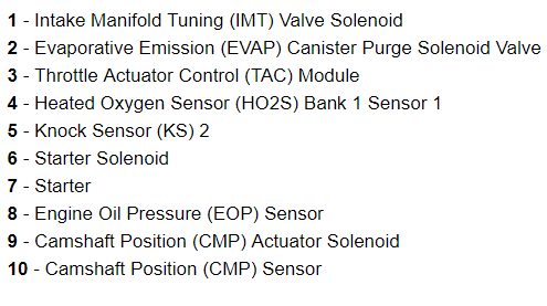

knock sensor
2007 PONTIAC G6
THERRIAULT1

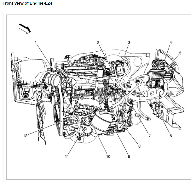

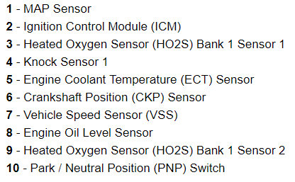

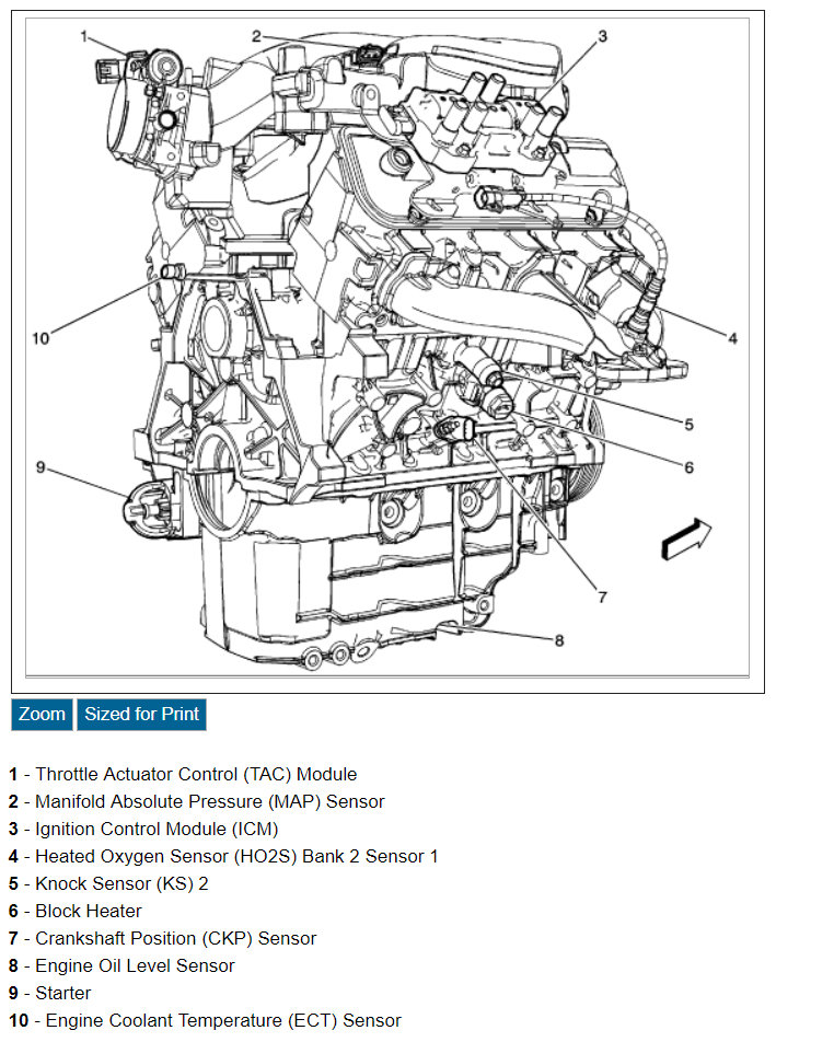

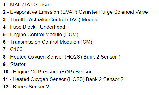

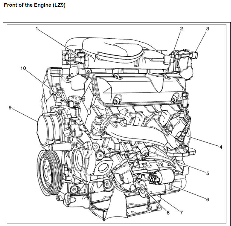

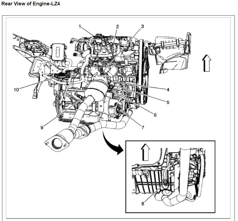

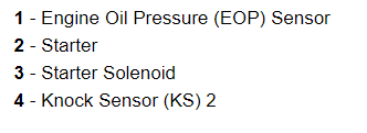

Engine Performance problem 6 cyl Front Wheel Drive Automatic 55922 miles It has the 3.5L
Where is the knock sensor located in this car and what does it look like any photos would be great thanks!
Oct 4, 2009 at 1:46 PM
  • 55,432 POSTS

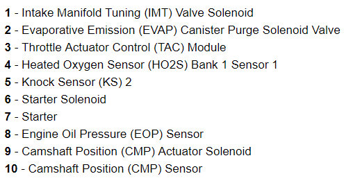

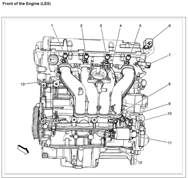

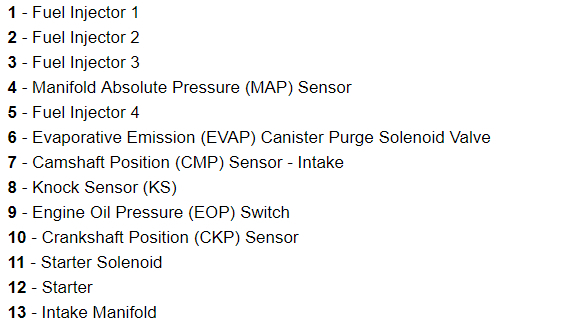

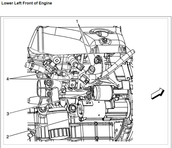

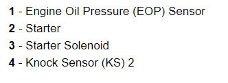

There are many engine and some engine have 2 knock sensors so I have included all of the engine options for the knock sensor locations (below) they show all sensor locations btw.
