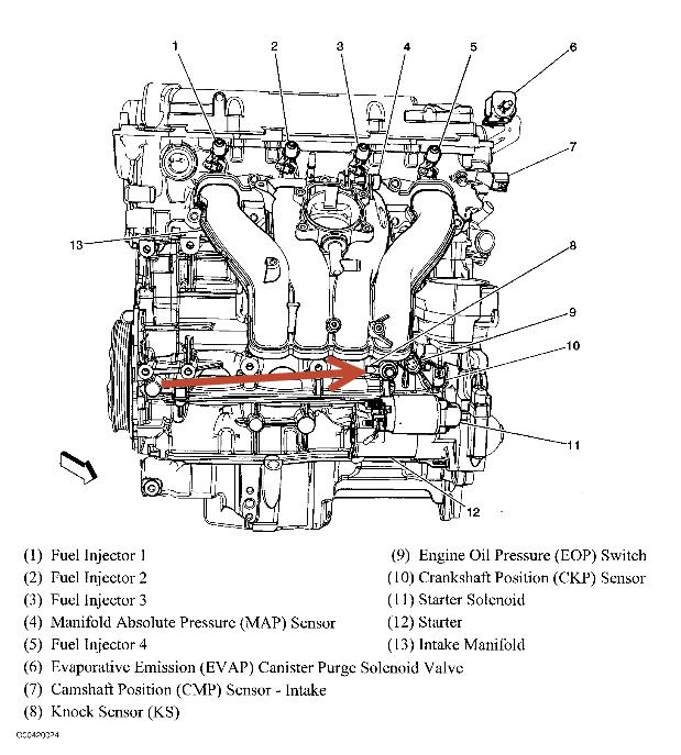

knock sensor
2007 PONTIAC G6
160,000 MILES
PIRSQ
Can you tell me the location fo the knock sensor? I have the base model with a 4 cylinder engine. The diagnostic codes were P0325 and P0327 which indicate a Knock Sensor circuit low input and circuit bank. I can not find the location of the sensor in order to replace it. An image would be most helpful.

The knock sensor is located in the engine block above the starter, item 8 in drawing.
