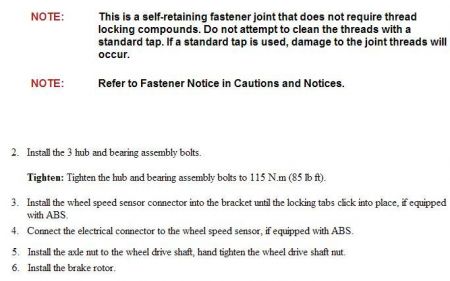

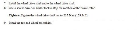

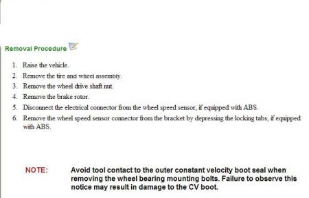

How do I replace a wheel bearing on the front.
