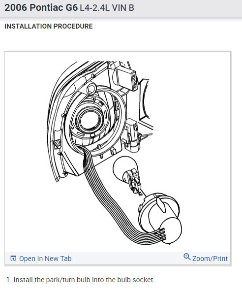

how do you replace a headlight bulb?
Mar 9, 2010 at 2:27 AM
SQM
  • 6,383 POSTS

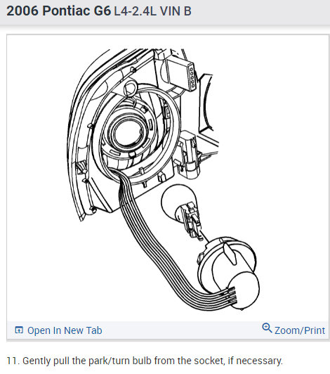

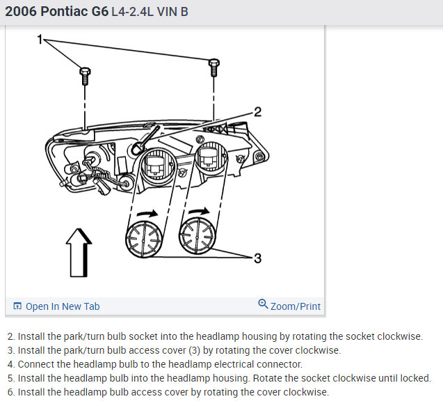

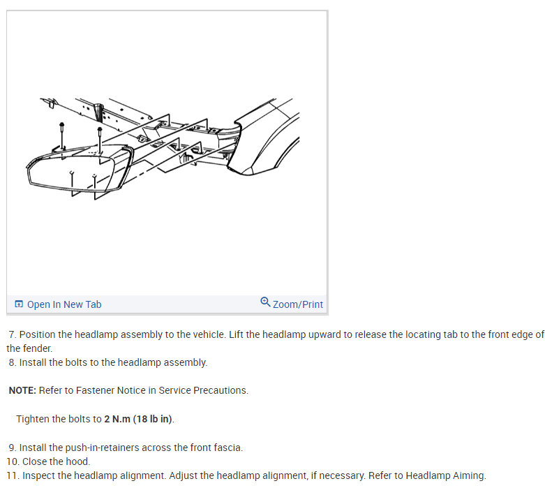

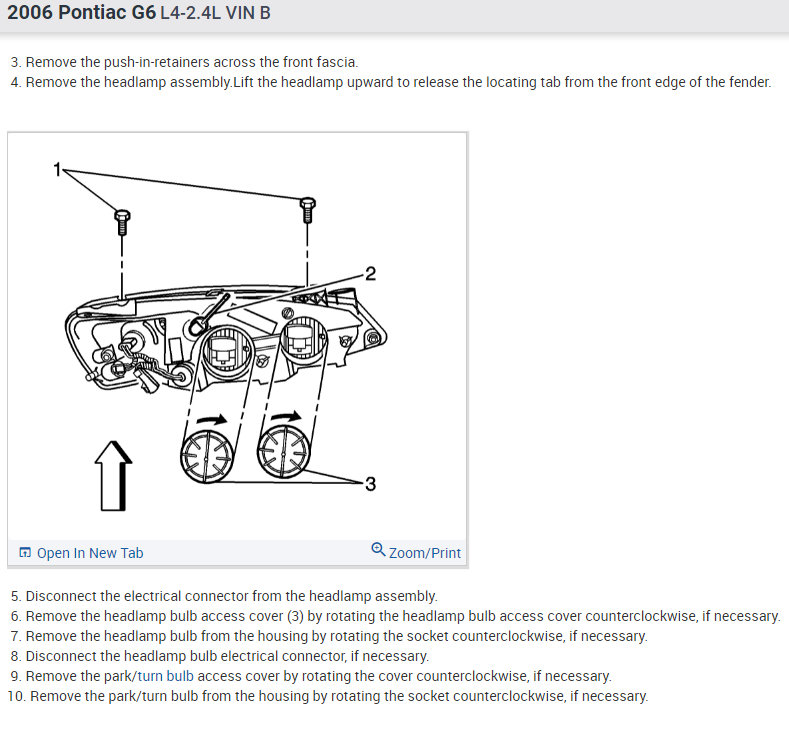

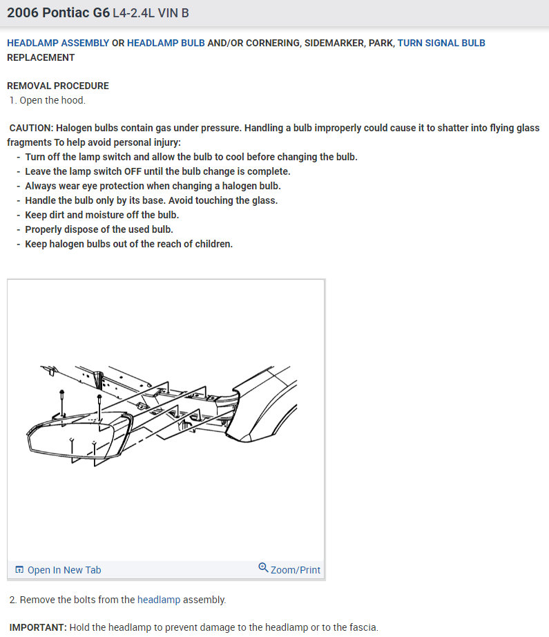

In order to replace a headlight bulb you will have to remove the headlight assembly.
Be sure to turn the headlight switch to off until the replacement is complete.
Handle the bulb only by its base.
Avoid touching the glass. Care full to keep dirt and moisture off the bulb.
To remove the headlight assembly you will have to take off the bolt that hold it in place. Then tilt up and pull out to remove the assembly.
