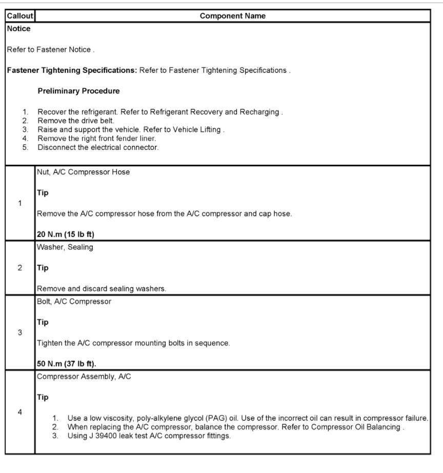

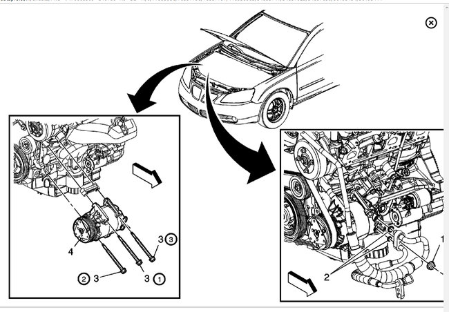

Unless the evaporator is damaged in some way like where the expansion valve bolt's up or he say's there is some kind of restriction in it then i don't see why those would be a matched pair to have to replace both of them at the same time.Ask him why he has to replace the evaporator core and let me know his reason and i will tell you what i think about it.
Usually you need to replace the compressor with the expansion valve is that what he meant?
Here are some guides to help see whats going on.
https://www.2carpros.com/articles/re-charge-an-air-conditioner-system]
and
https://www.2carpros.com/articles/replace-air-conditioner-compressor
Cheers,
