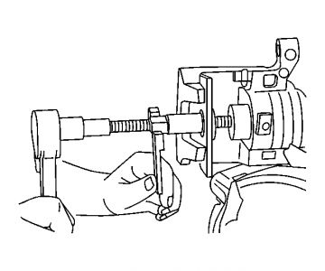

e brake will not go back in
2006 PONTIAC G6
MATROB
rear caliper w/ebrake will not go back in even when i apply pressure with c--clamp....do i have to release something on the ebrake to get it to retract.....
Aug 23, 2009 at 4:56 AM
BMRFIXIT
  • 19,053 POSTS
Special tools is needed to push and spin the caliper piston at the same time using the C clamp will damage the caliper
