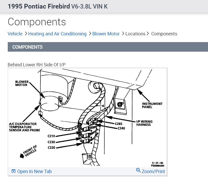

ok i have a pontiac,firebird,1995,169,000 mileage.3.4sfl.ok my a/c doesnt work some ppl tell me that the blower may be out or that the wires are not connected right but i dont kn where that blower is so it would be nice if any one would tell me where the blower is and maybe some other things that could help me with the problem

The blower motor is under the dash on the right side here is a guide that can walk you through the repair and diagrams below to show you how on your car.

Blower motor is behind the right side of the instrument panel. When you take it out jump start it with the battery Does it work? if it does check the motor resistor on the blower housing-okay there do continuity test on the control switch. Something has to give.

The blower motor is under the dash behind the right side of the instrument panel. Remove it and apply battery power to test it. If it runs, check the blower motor resistor on the housing and test the control switch for continuity.
