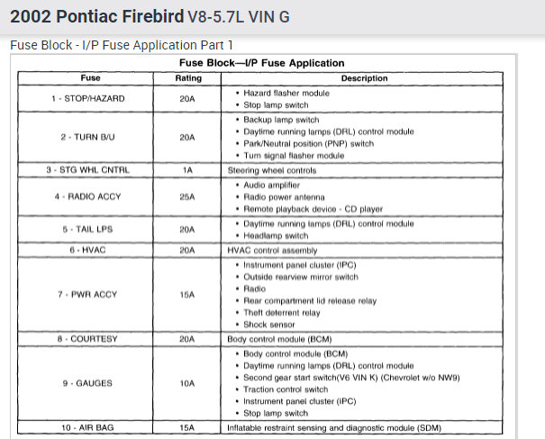

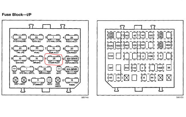

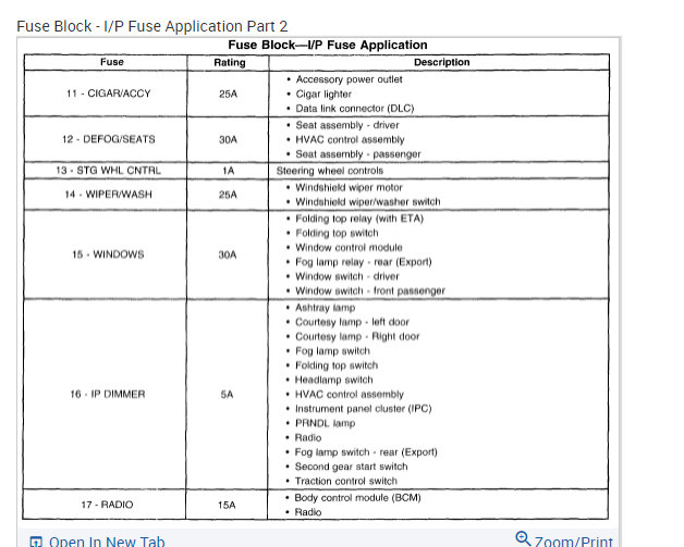

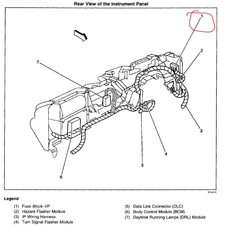

It is likely due to a burn fuse that power the diagnostics port.
Check the fuse number 11, in the fuse box that is located on the lest of the instrument panel it should be a 25A fuse.
