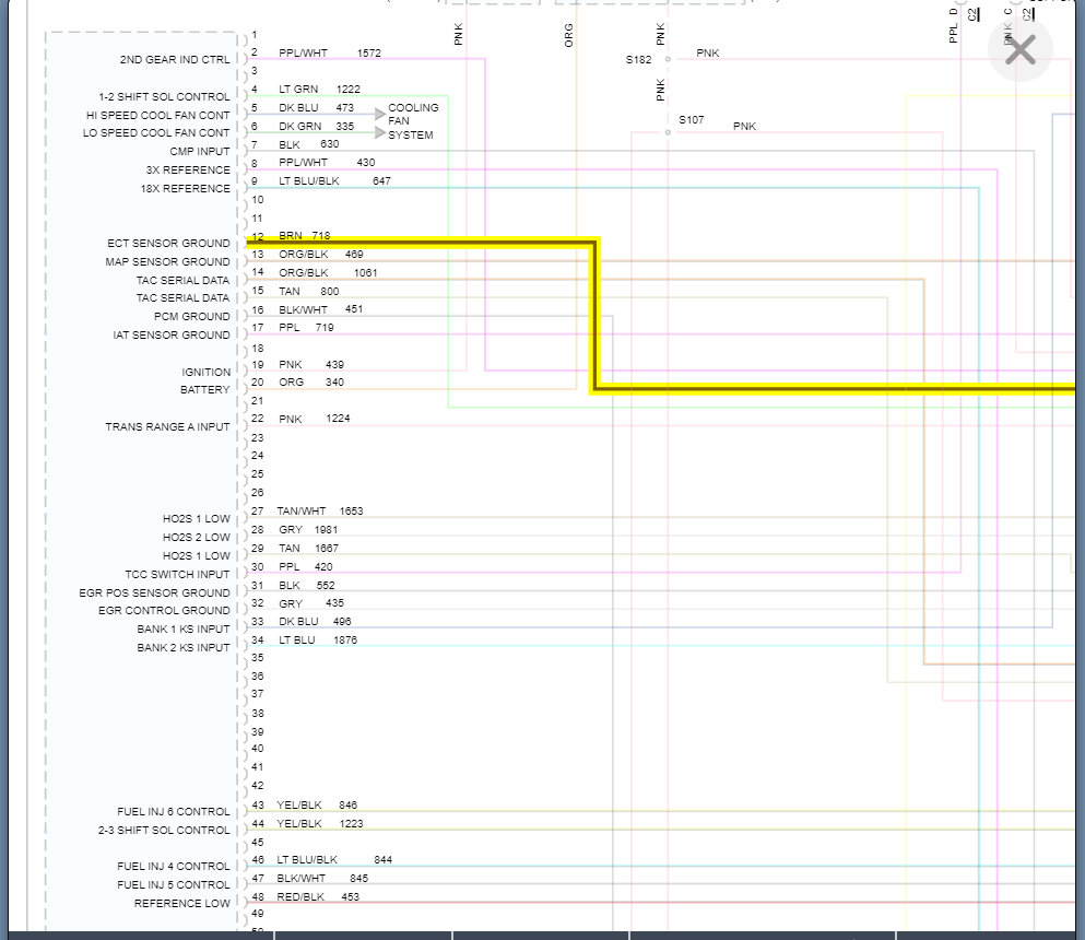

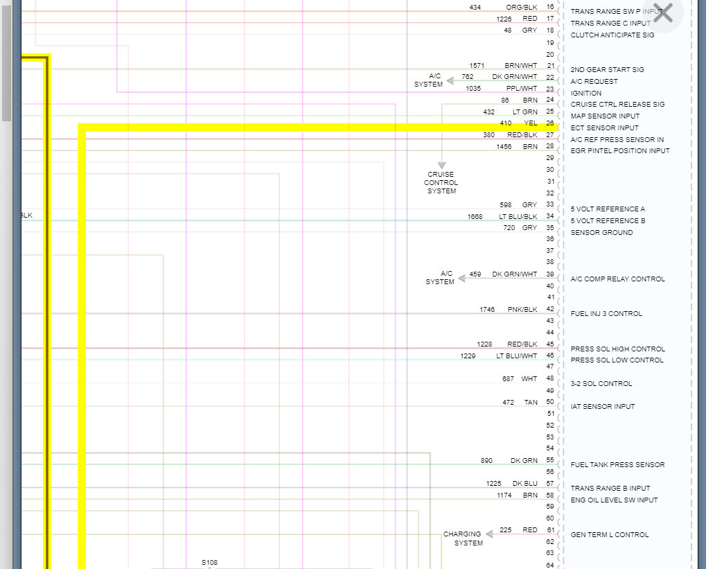

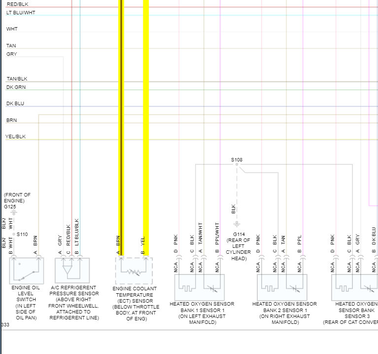

Yes. This very well could be the temperature sensor. So, we need to start with checking the resistance across the sensor and make sure it is not an open circuit.
Then we need to check the voltage as the engine warms up. If it doesn't change then you need to replace the sensor.
I attached the wiring diagrams below. Please run through this and report back what you find.

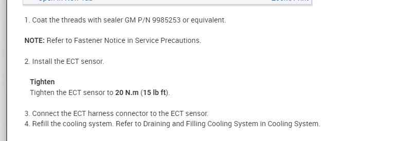

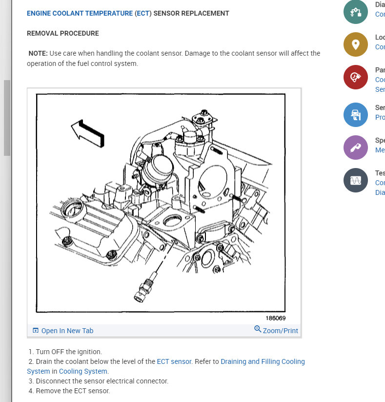

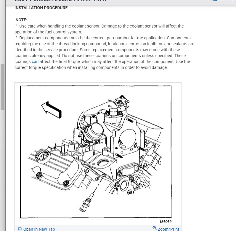

Assuming the temperature sensor is the issue I attached the process on how to replace it.
