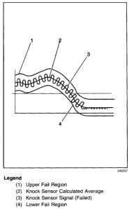

The PCM contains integrated Knock Sensor (KS) Diagnostic Circuitry. Input signals from the knock sensors are used to detect engine detonation, allowing the PCM to retard Ignition Control (IC) spark timing based on the amplitude and frequency of the KS signal being received. The knock sensors produce an AC signal under all engine operating conditions. The PCM calculates an average voltage of each knock sensor's signal and takes instantaneous signal voltage readings. The PCM uses the instantaneous signal voltage readings to determine the state of the knock sensor circuitry. If the knock sensor system is operating normally, the PCM should monitor instantaneous KS signal voltage readings varying outside a voltage range above and below the calculated average voltage (as shown in the normal knock sensor figure). If the PCM detects a knock sensor signal voltage within the calculated average voltage range, DTC P0327 or P0332 will set (as shown in the abnormal knock sensor figure).

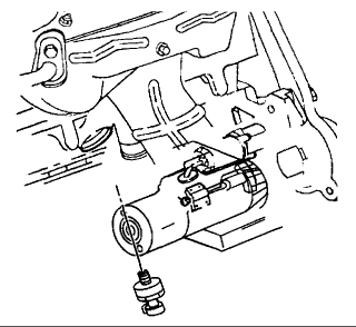

REMOVAL PROCEDURE Drain the cooling system. Disconnect the wiring harness connector from the appropriate knock sensor. Remove the knock sensor from engine block. INSTALLATION PROCEDURE IMPORTANT: Do Not apply thread sealant to sensor threads. Sensor is coated at the factory and applying additional sealant will affect the sensors ability to detect detonation. NOTE: Refer to Fastener Notice in Service Precautions. Hand start the knock sensor into the engine block. Tighten Tighten the knock sensor to 19 N.m (14 lb ft) . Connect the wiring harness connector to the appropriate knock sensor. Fill the cooling system. Left sensor location In the bottom left side of the engine block Right sensor location In the bottom right side of the engine block Cat System

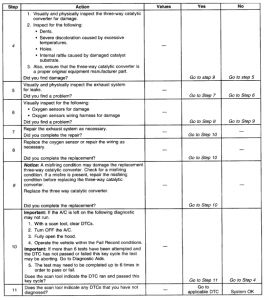

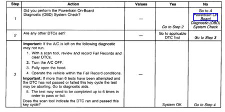

The numbers below refer to the step numbers on the diagnostic table: The powertrain OBD system check prompts the technician to complete some basic tests and store the freeze frame and failure records data on the scan tool if applicable. If any other DTCs are set, diagnose those DTCs first. A fault in a component can cause the converter to appear degraded or may have caused its failure. Clearing the DTCs allows the catalyst test to be attempted 18 times and completed up to 6 times this key cycle. If the A/C is ON the diagnostic may not run. The engine must be warmed-up. The converter needs to be warmed-up by raising the engine speed more than idle for the specified time prior to each attempted test. Check and see if DTC passed or failed this key cycle. If the DTC does not pass or fail look for a possible reason that would cause the test to abort. This step includes tests for conditions that can cause the three-way converter to appear degraded. Repair any problems found before proceeding with this table. If the three-way converter needs to be replaced, make sure that another condition is not present which could damage the converter. These conditions may include: misfire, high engine oil or coolant consumption, retarded spark timing, weak spark or a plugged/leaking injectors. Correct any possible causes of converter damage before replacing the converter.
