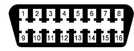

1997 Pontiac Firebird, 3.8 v6, fully loaded with power options. Last week i was driving and from out of nowhere, the engine cut out instantly. I coasted off to the side of the road and tried to restart, but when i turn the key forward, nothing on the dash lights up and the starter will not engage. The headlights and horn still work, but there is no power when the key is turned on. I replaced the ignition switch under the dash(which is not an easy job). Since then I have checked all the fuses under the hood and inside the car, none are blown. The ODB tester wont even light up when plugged in to give me a code because there is no power going to the harness. Could there be an inline fuse somewhere that I dont know about? Or could it be the starter? I would think that even if the starter was bad, power should still flow and light up the dash when the key is turned forward. Being a full time college student, I dont really have the money to take the car to a dealer to have the problem fixed. Ive been fixing junk cars ever since i started driving, so I feel confident that if I know what is wrong, I can repair it. I just cant figure out what the problem with this car could be, Im stumped. Any help would be greatly appreciated. Thank you very much.

Hello, As far as the scanner, I'd check that pin 16 at the datalink connector has voltage, should be hot all the time. If no voltage check the cigar fuse, check the fuse circuit is hot. There is a theft system that could effect starter. I wouldn't think that would effect your dash? Did you try a different key? I might have to check feed to and from the ignition switch.

Ok, i checked the #16 pin, no voltage there. I pulled the fuse for the cigar lighter and it was fine, but no voltage there either when i probed it with the test light. Unfortunately I only have 1 key for the ignition, and yes it does have the chip in it. Maybe the chip in the key somehow went bad? The headlights, horn, and 4 way flashers still work, and i checked the battery, it has more than enough power. Could it be possible that the wire going to the starter is bad, not allowing power to flow through the circuit, therefore not getting power to the ignition switch when the key is turned forward?

Ok, I took a test light and checked for power at the cigar lighter in tghe fuse block and there is no power. Also, no power in the #16 pin where the ODB tester plugs in(supposed to be hot at all times right?) Replaced all the fuseable links under the hood. The wire going to the starter is fine, no corrosion or cracks or breaks, the wire was checked with the test light and has no power. The car is equipped with the VATS(vehicle anti theft system) from the factory and the key has a resistor or "chip" in it. I had a new key cut at the dealer thinking the resistor was bad, but still no luck. Upon further reading online, I have seen some people have problems with the VATS system, but nothing says that the dash does not light up like on my car. All I've seen about this is that the starter and fuel pump will not work, but the dash still lights up. I have seen an article on how to bypass this, but I would rather not unless it is the last resort. I climbed under the car and shorted the starter to see if it still works and it does, but the car wont start because the fuel pump is not working because of the current ignition problem. I am totally lost as to what else I can check or replace. I don't see any fuses inline anywhere, and all the fuses inside the dash panel are fine, and so are the fuses and relays under the hood. I go back to college Tuesday morning and am really hoping I can have the car fixed by then. I am totally stumped on this one. Anybody with any help or ideas, I would greatly appreciate any info you might have. Other than replacing the entire VATS system and rewiring the entire ignition system, what else is there left to do that I havent done yet? Looking to save the $130 towing fee to the dealership, and the hundreds they might charge me to resolve the problem. Thank you so much in advance for any helpful info on my problem.
