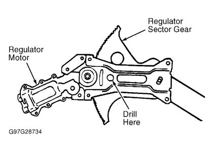

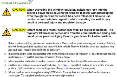

Is there any way someone can show a basic step by step design of how the regulator and motor are mounted into the door. I have seen it for other cars, but not for the firebird. My mother's automatic windows have failed, and I think I can replace the parts with a little help from someone. Thanks for your time...

https://images.2carpros.com/forum/automotive_pictures/261618_Noname_1110.jpg
FIG. 1
https://images.2carpros.com/forum/automotive_pictures/261618_Graphic_206.jpg
