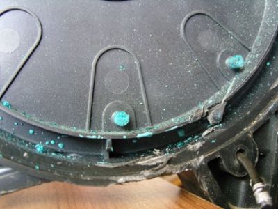

Bought 96 trans am 3 months ago and had to do some repairs, new radiator, new water pump, distributor, spark plugs, wires. Basically I got the car running. No problems what so ever. 3 week ago we had a huge thunder/rain storm coming to town and on my way home I rant into a couple water puddles but the was no problem, I made a stop, shut the car down bought what I needed and left, after I started the car and was about to take off the car died, it just died like when someone in the Matrix get suddenly unplugged. Anyway I got the car starting and I made it home and it died again right when I was pulling in the driveway. I figure something got wet so I decided to leave it set. The next day the car started normally and went to work, 5 hours later the car wouldnt start and I was getting a p1371 code. Ever since that day I have manage to start the car a couple of times, Driven the car around the block, flooring it to high speed on the back road near my place, let it idle for as long as possible, but the car always dies, the same way I mentioned above. I have cleared the computer many times, sometimes the code comes back right after the pcm has been cleared. So right now the car is just sitting because it not realiable and I have run out of options. I have installed a new ignition coil, a new ckp sensor and the last thing I put in was a brand new wire harness that connect the opti-spark to the ECM after a tech at the dealership told me that the harness might be a proble if the resistance was off range. Also 1 out of 10 times I getthe car started it dies like if it was chocking and I smell gas (i figure the plugs arent getting a charge) So my question is, Did I have bad luck and the sensor inside the distributor got damage with the water and I need to replace it again? I cant drop more money into the problem without getting results.

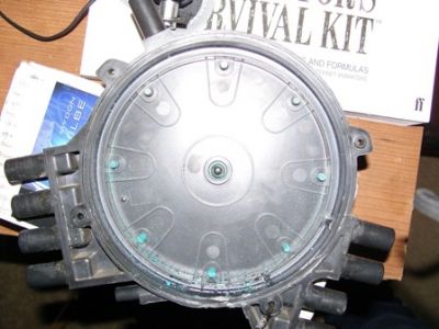

Well I installed a new ICM and the car didnt start until the third time, and it was running excellent, shut it off and it would start any more. I notice that a few times I heard the crankshaft moving a couple times. And the air pump/blower start when I turn the ignition to on and runs again when I stop trying to start the car. I have a Dynaspark distributor at home right now so I hoping that will fix the problem. I did get another code besides the p1371. But it was also about the the opti-spark sensor missing pulses. So we will see.
Thanks for your help. I will be back onec the distributor is installed.
Wednesday, July 9th, 2008 AT 3:42 PM
SOLIDUSKAL
  • 12 POSTS
Thank for all your help. I found out that the raplacement distributor that i had installed 3 months ago was wet and had develope some kind of corrosion inside(here is a picture) I installed a dynaspark distributor and the car has been running fine.
