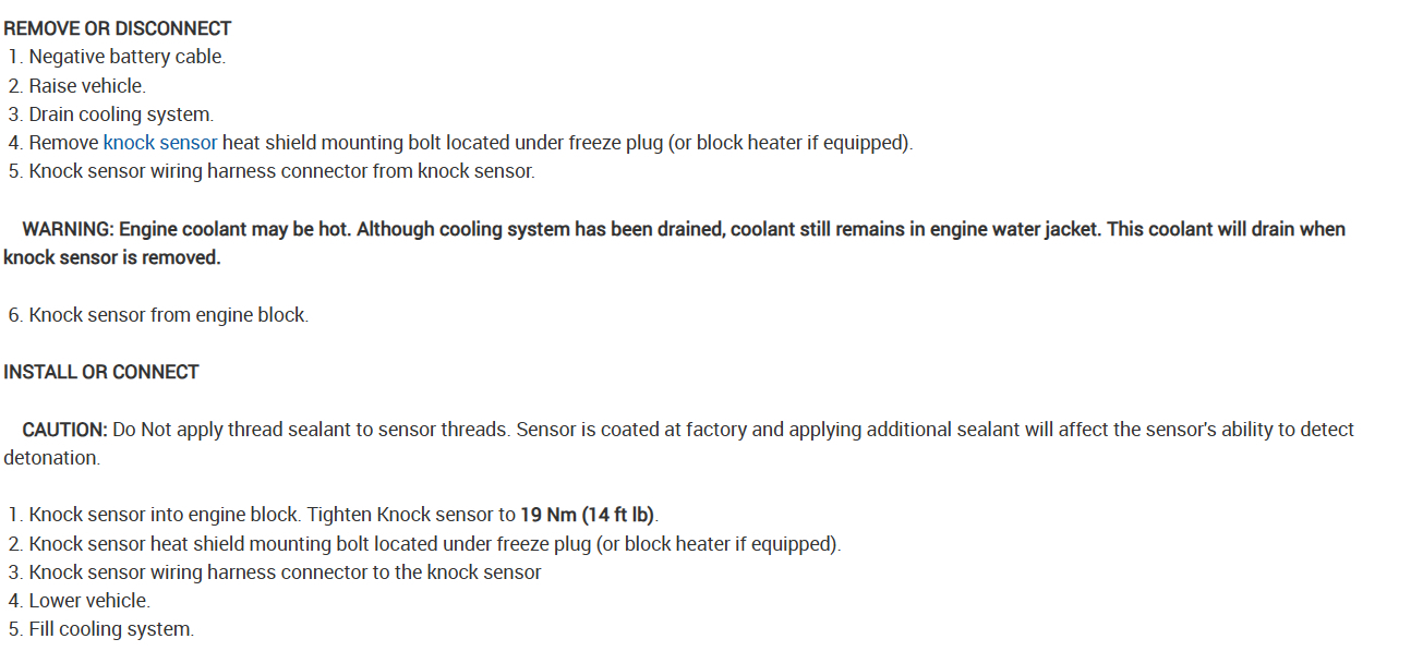

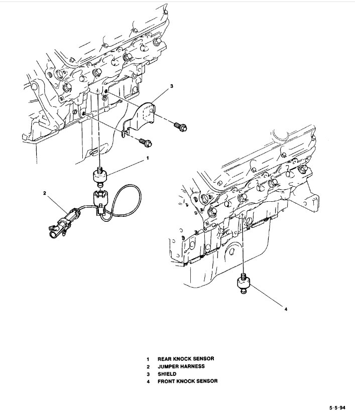

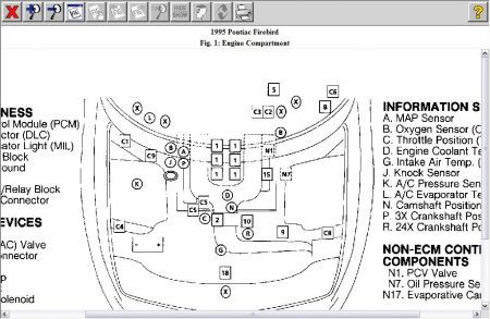

Where exactly are the knock sensor located at on the engine?
Dec 16, 2007 at 6:34 AM
  • 75,992 POSTS
3.4 liter
https://images.2carpros.com/forum/automotive_pictures/12900_3_3.jpg

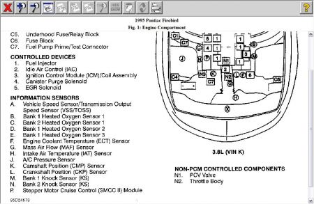

3.8 liter
https://images.2carpros.com/forum/automotive_pictures/12900_knock_sensor_3_1.jpg
Dec 16, 2007 at 7:52 AM
  • 55,423 POSTS

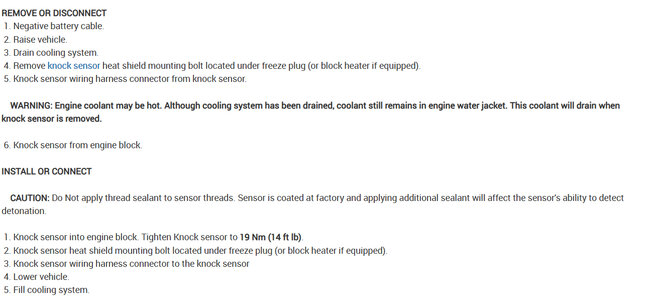

Here are the instructions and the location of the knock sensor which is down low on the engine block. Check out the images (below). Let us know if you need anything else.
