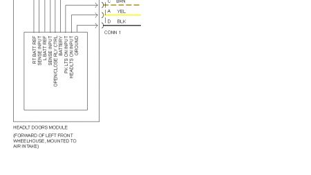

I TURNED ON THE HEADLIGHTS AND THEY OPENED UP, BUT WHEN I TURNED THE HEADLIGHTS OFF BOTH LIGHTS STAYED OPEN. WHEN I LISTEN I CAN NOT HEAR THE MOTOR ON THE HIDE AWAY LIGHTS RUN AT ALL. I CAN NOT FIND THE FUSE TO CHECK BUT I CHECKED ALL THAT I FOUND AND FOUND NOTHING. CAN YOU PLEASE HELP.

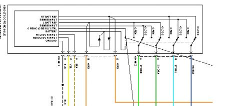

I suspect the headlamp door module. Two wires at lamp door motor, voltage and ground, reversing motor, the circuits switch, depending on whether the door is opening or closing. You can check circuits, if you want?
https://images.2carpros.com/forum/automotive_pictures/512072_firebird_headlamp_door_module_1.jpg
https://images.2carpros.com/forum/automotive_pictures/512072_firebird_lamp_door_module_circuit_1.jpg
The blue wires are for one lamp door motor. The green wires are for the other.
