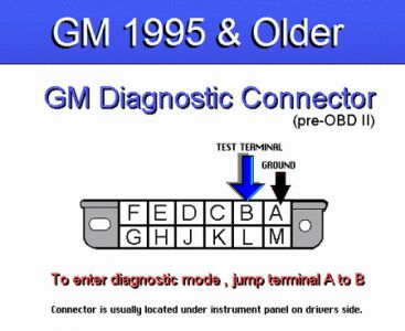

https://images.2carpros.com/forum/automotive_pictures/62217_95_OlderGM_7.jpg
Cross these two terminals as shown, then turn the key on. Count the flashes, a 22 will flash as 2 flashes then a short pause, then 2 flashes, if more than one code is stored, the pause will be longer. The codes will display three times and end with 12. Write them down and post here. If no codes show...test fuel pressure. https://www.2carpros.com/car_repair_video/test_fuel_injection_pressure.htm Go here and checkout our video.
