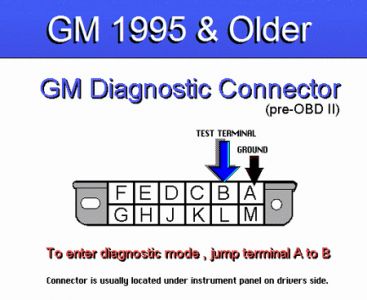

Is the service engine soon light on? or flashing?
https://www.2carpros.com/forum/automotive_pictures/62217_95_OlderGM_9.jpg
Cross these two terminals as shown, then turn the key on. Count the flashes, a 22 will flash as 2 flashes then a short pause, then 2 flashes, if more than one code is stored, the pause will be longer. The codes will display three times and end with 12. Write them down and post here.

Reply to PM: If you are totally inexperinced this will be tough. We need the codes stored in the computer to proceed, so that's why I posted the picture, you will find this connector under the dash to the right of the steering colmn. Put a paper clip or small piece of wire in the two terminals as shown and count as instructed, write the codes down, then post the result here.
