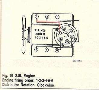

1989 Pontiac Firebird 6 cyl Two Wheel Drive Automatic 160K miles
I must have put the wires on wrong on the new cap I replaced.If I could get a diagram of how to put the wires on the cap of my 6 cylinder 2.8 motor it would be greatly appreciated. 1989 Firebird. Thank You for your response
updated 3/12/09
Thank you very much my car runs fine now...

Here is the location of the firing order, the picture might not be to good but you will see where i maked #1 plug and wire in red. the firing order is 1-2-3-4-5-6 and from the front of the engine number 1 is on the left as you face the engine with number 2 on the oppsite side
