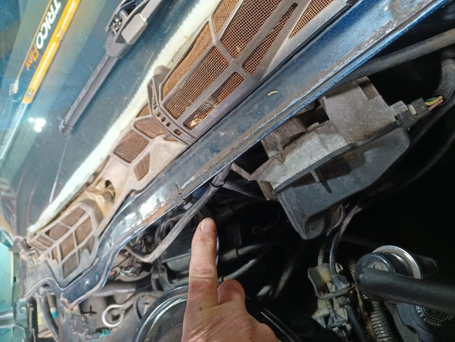

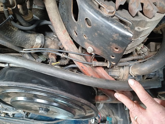

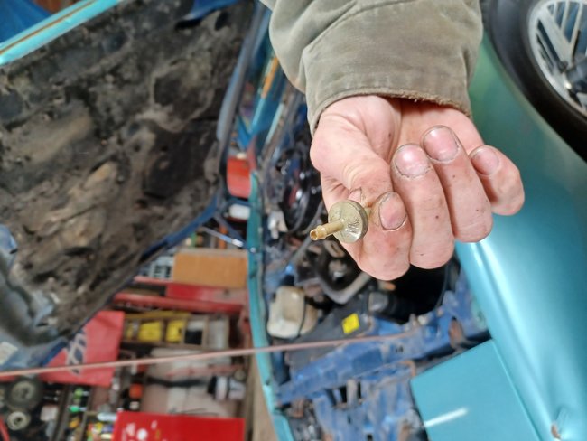

We worked on this for days after buying a pump which didn't change anything. We added a check valve to the line in the container and then primed the line at the end by the pump and it worked 100% . This was one i had but after looking i see there is one on a vacuum line on the motor so you should be able to get one. Please let me know if it works for you .i couldn't find an answer anywhere so wanted to post this. Hope it helps.
