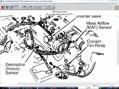

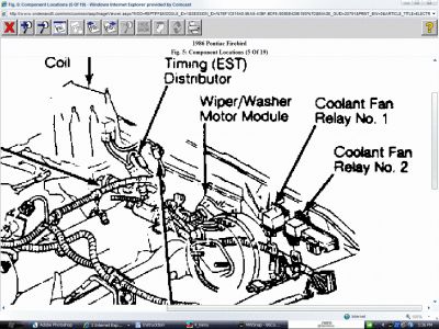

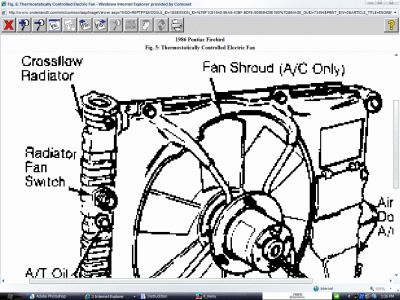

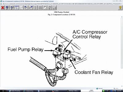

the fan will not run unless air conditioner is on. I have changed out the Fan relay switch with no results. I have changed out the fan switch / heat sensor at the thermostat and a new thermostat, still fan will not come on when heat gets above 180 degree. What else am I missing?
Jan 14, 2008 at 3:58 AM
MERLIN2021
  • 17,250 POSTS
Have you tried a test light to check for voltage in the wires? These fans are controlled by the fan switch in the radiator, and an overide for the a/c...238 degrees to turn fan on...The teset is to unplug the connector, use 14 gauge wire to the battery, and fan should run. If not defect list could include , car battery, coolant relay, coolant temp switch, or a/c relay....check all! Relay locations vary by engine size and carb or fuel injected...
https://images.2carpros.com/forum/automotive_pictures/62217_86Cooling_Fan_1.jpg
https://images.2carpros.com/forum/automotive_pictures/62217_86Cooling_FanRelay1_1.jpg
https://images.2carpros.com/forum/automotive_pictures/62217_86Cooling_FanRelay_1.jpg
https://images.2carpros.com/forum/automotive_pictures/62217_86Cooling_FanRelayCarb_1.jpg
