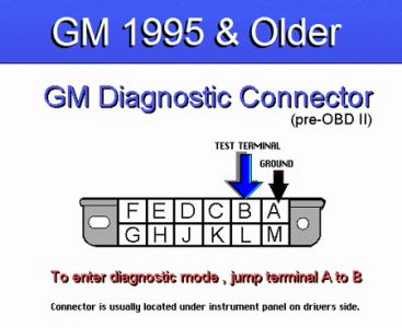

Cross these two terminals as shown, then turn the key on. Count the flashes, a 22 will flash as 2 flashes then a short pause, then 2 flashes, if more than one code is stored, the pause will be longer. The codes will display three times and end with 12. Write them down and post here. This connector is right under the middle of the dash...

This is a 1979 trans am. It does not have a GM 1995 & older diagnostic connector.

Sorry, that started in 81....check the tac wire, if it grounds aywhere the engine wont run...Prety sure it's tan colored...been a while since I owned my 6.6!
