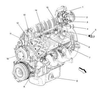

Where is the PCV valve located on a 2005 Pontiac Bonneville 3.8 Litre V-6 engine, and (or) does this engine have a PCV valve

Component number 12 in diagram below...it is directly under the MAP sensor.
