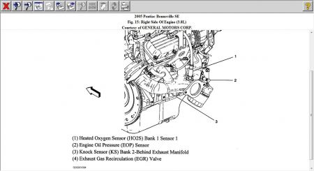

I need to determine where the oil pressure switch is located on the engine.
Thanks
May 17, 2010 at 2:44 PM
  • 75,992 POSTS
Hi Ron Jordan, Welcome to 2carpros and TY for the donation The engine oil pressure sensor for a 3.8L is on front of engine below the power steering pump
