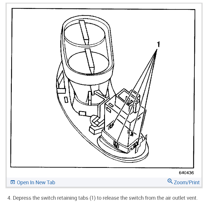

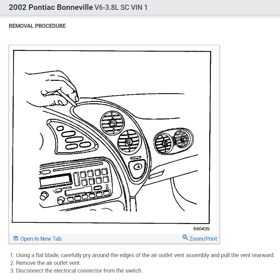

Just blew 2 fuses as I replaced them for the turn signals. Can't find the relay on this car. Not in either fuse box?
Dec 15, 2009 at 4:38 PM
  • 110,194 POSTS

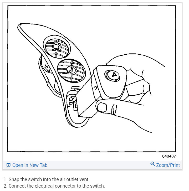

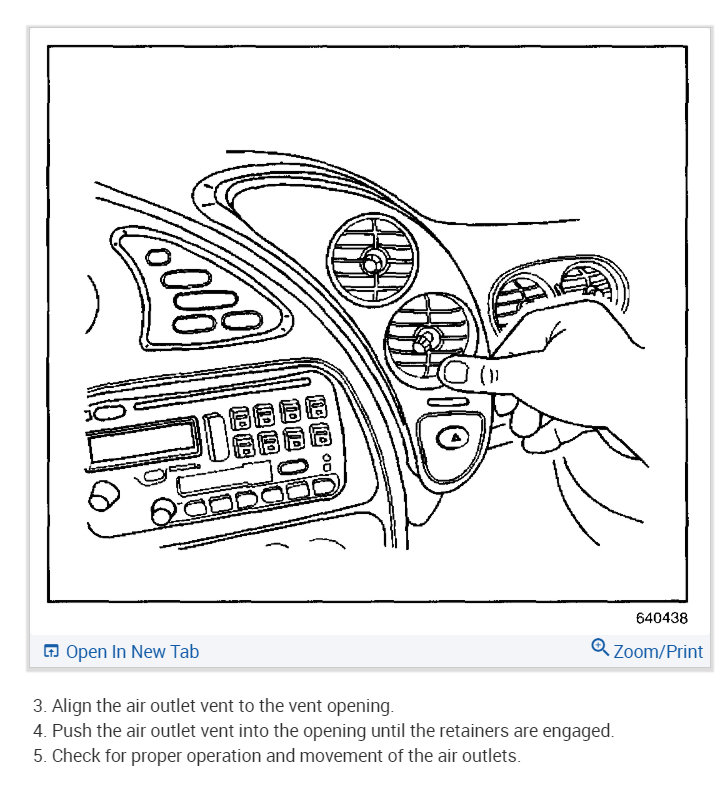

The turn signal flasher and hazard flasher are the same thing here is instructions in the diagrams below on how to change it out. Check out the diagrams (Below). Please let us know if you need anything else to get the problem fixed.
Dec 15, 2009 at 10:38 PM
ADWOODS28
Thanks you I got a new one for $67.00 all fixed I love this site.
