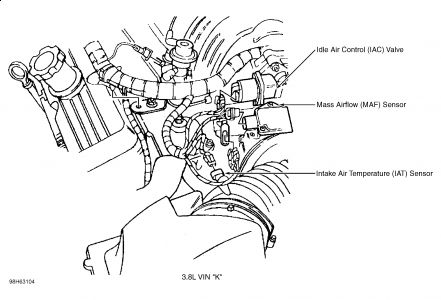

Where is the Intake Air Temperature sensor on a 2002 Bonneville SE?

Intake Air Temperature (IAT) Sensor (3.8L VIN K) located On left side of engine compartment, in air intake duct.
https://images.2carpros.com/forum/automotive_pictures/99387_Graphic1_453.jpg
Intake Air Temperature (IAT) Sensor (3.8L VIN 1) located On left side of engine compartment, in air intake duct
