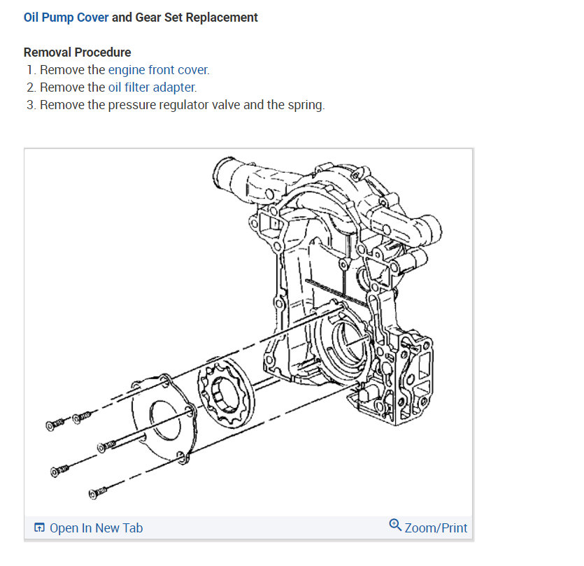

On the way to work this morning, my oil pressure went from 40psi to 120 psi and the Service Engine Soon light came on. The repair shop says it will be $1500 to fix. They said there is a leak between the coolant system and the oil line and that there is coolant in the oil. Does this sound right to you?
Wednesday, December 5th, 2007 AT 12:41 PM
  • 52,797 POSTS
Good afternoon,
First, this does not sound right.
I would take it somewhere else and have them check the actual oil pressure to be sure the gauge is correct. It may be a bad sender unit.
https://www.2carpros.com/articles/high-oil-pressure

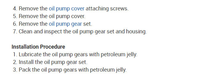

If the oil pressure is that high, it needs an oil pump. The regulator inside is stuck open and is not regulating the pressure.
