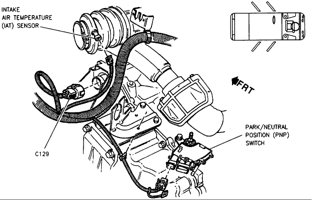

Where is the neutral safety switch located? Car will not crank. Starts sometimes and it is not the battery or the starter.

CJ MEDEVAC
  • 11,005 POSTS
This is what it looks like:
http://shop.advanceautoparts.com/p/bwd-neutral-safety-switch-ns38003/20971213-P?searchTerm=back-up%2Fneutral+safety+switch
On the side of the transmission.
Have you tried to start it in 'neutral'?
The Medic
Monday, July 2nd, 2018 AT 11:38 AM (Merged)
MELISSA FLAUGHER-RATCLIFF
Yes, we have tried everything. Thought it was the crank sensor but it is not. Where the neutral safety switch is suppose to be its not there. About to give up.
-1
CJ MEDEVAC
  • 11,005 POSTS
I could not find a diagram in 'Prodemand', I searched quite a while on the net.
Seems it is also called a 'PNP'
Diagram below, I hope it helps.
The Medic
