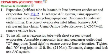

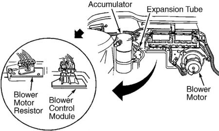

I am looking to replace expnasion tube or orifice tube on my 2001 Pontiac Bonneville. I have looked in different locations and could not locate. Could you please tell me exactly where it is located on my vehicle.

https://images.2carpros.com/forum/automotive_pictures/55316_01bonnevilleorifice2_1.jpg
https://images.2carpros.com/forum/automotive_pictures/55316_01bonnevilleorifice_1.jpg
You do realize that you need to evacuate the entire AC system before you start the work using proper equipment and not into the atmosphere, right? And you need to re-evacuate the system to vacuum before you charge it with R134a?
