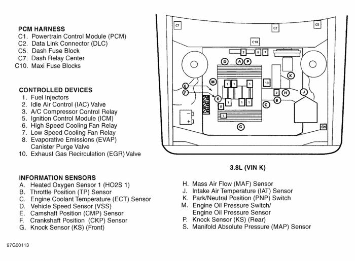

STEVEN BRUMFIELD
where is the computer brain box located on a 1997 pontiac bonneville because it wont start sometimes if it has been driven a little bit when its warm i,ve heard the 3.8,s have a history of this?
Dec 17, 2020 at 3:57 PM (Merged)
DOCFIXIT
  • 18,828 POSTS
Hello the PCM or brain box is located at the left front engine compartment. Check out the diagrams (Below). Please let us know if you need anything else to get the problem fixed.

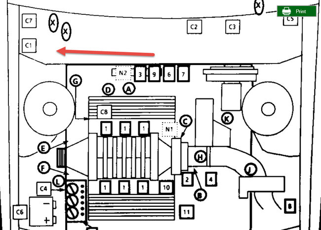

MICHAEL SCHEFFLER
Where is the PCM located and what are the color codes for each plug?
HMAC300
  • 48,601 POSTS
there is only one plug as it is OBD1. see picture for location behind right hand side of dash do not forget to take prom out for new ECM.
