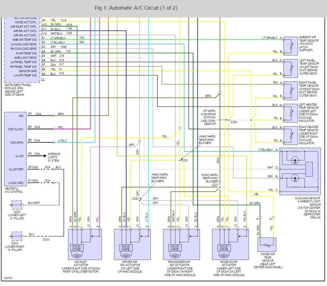

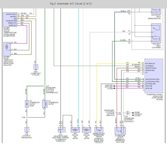

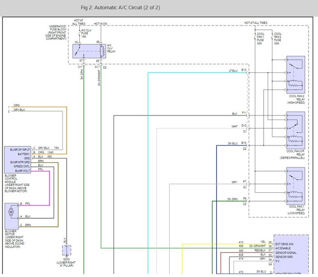

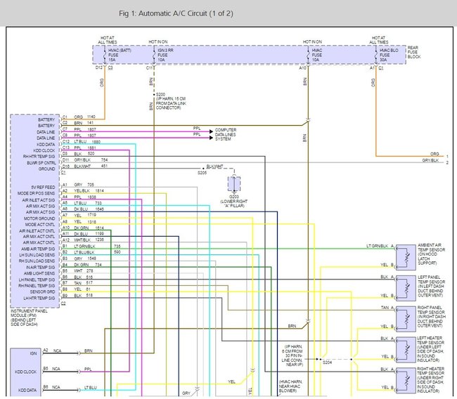

Air Conditioning problem 6 cyl Front Wheel Drive Automatic 311000 miles
I was having trouble with my power door locks and push button trunk release and interior lights, so I was in the fuse box under the back seat checking things out. Ever since my AC compressor will not turn on. Help. I cannot find a fuse under the back seat marked AC. The problem with my power door locks/ interior lights/push button trunk release mysteriously disappeared after I got out of the 100 degree hellish Texas heat& back in Minnesota.
I checked this fuse and it is good. Swapped it out anyway. AC still not working. There is no power to the 2 prong hookup that connects to the compressor when I have the AC on. I think there should be. Any more suggestions? Thanks. Mike PS I also switched out the AC relay inside the fuse box under the hood. It was good also
Jun 21, 2010 at 4:39 PM
  • 54,861 POSTS
There is 4 fuses for the system to work, a compressor relay and a ac pressure switch that can do bad, here is a some wiring diagram and a guide to help you figure out whats going on.
Check for power at the pressure switch.
and
also the compressor will not come on if the system is low.
https://www.2carpros.com/articles/air-conditioner-how-to-add-freon
Please run some tests and get back to us so we can continue helping you.
