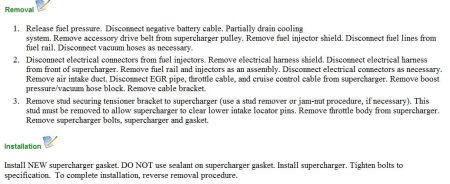

Is it a hard job to take off the supercharger, to get to the engine so the intake manifold gaskets can be changed. I have never done this before. What would be the first step?

https://images.2carpros.com/forum/automotive_pictures/261618_Noname_2754.jpg
