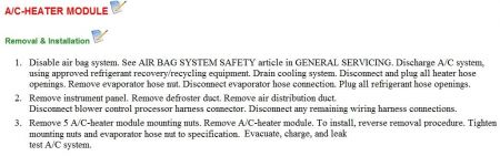

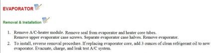

need instruction on how to replace a/c evaporator
Jul 18, 2010 at 12:31 AM
BLUELIGHTNIN6
  • 16,542 POSTS
https://images.2carpros.com/forum/automotive_pictures/261618_Noname_2477.jpg
https://images.2carpros.com/forum/automotive_pictures/261618_Noname2_809.jpg

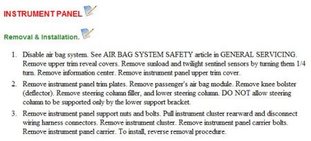

Thanks for the input having trouble getting my dash out other than that seems to be going well if you have some info on the dash removal i would appreciate it Thanks again.
Jul 18, 2010 at 10:10 PM
BLUELIGHTNIN6
  • 16,542 POSTS
https://images.2carpros.com/forum/automotive_pictures/261618_Noname_2479.jpg
