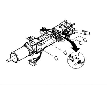

How do I install a new multifunction windshield wiper switch in my 2000 Bonneville?

Hello - Here is the info you requested....... Disassembly Procedure Remove the upper and lower shrouds. Refer to Steering Column Trim Covers - Disassemble - Off Vehicle under Steering Column Service and Repair.
https://images.2carpros.com/forum/automotive_pictures/248015_1_116.jpg
Remove the wire harness assembly from the wire restraint clip (1). Remove the wire harness straps.
https://images.2carpros.com/forum/automotive_pictures/248015_2_60.gif
Disconnect the pivot and pulse switch assembly connector. Remove the pivot and pulse switch assembly in the following way: 5.1. Press on the locking tabs of the pivot and pulse switch assembly. 5.2. Pull the pivot and pulse switch assembly out of the switch mounting bracket. Assembly Procedure
https://images.2carpros.com/forum/automotive_pictures/248015_3_41.gif
Slide the pivot and pulse switch assembly into the switch mounting bracket so that the locking tabs snap into place. Connect the pivot and pulse switch assembly connector. Important: Improper routing of the wire harness assembly may damage the inflatable restraint steering wheel module coil assembly causing an inflatable restraint malfunction. Install the wire harness straps.
https://images.2carpros.com/forum/automotive_pictures/248015_4_32.gif
Install the wire harness assembly into the wire restraint clip (1). Install the upper and lower shrouds. Refer to Steering Column Trim Covers - Assemble - Off Vehicle under Steering Column Service and Repair.
