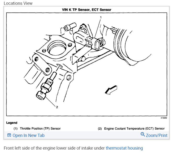

This condition can be caused by a bad engine coolant temperature sensor here is the location so you can change it out to see what happens. This guide will walk you through the steps with diagrams below to show you on your car.
https://www.2carpros.com/articles/coolant-temperature-sensor-cts-replacement
Check out the diagrams (Below). Please let us know what you find.

Does the sensor go off of the coolant sensor in the dash? My coolant temp in the gauge cluster works fine and reads around 200 degrees farenheit at operating temperature.
Sep 24, 2019 at 4:59 AM
  • 55,423 POSTS
Yes, the upper limits might be okay its the lower limits you need to look at. This guide can help as well:

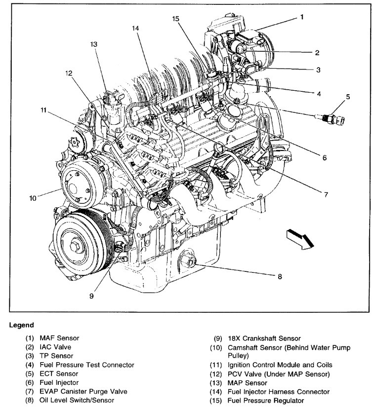

I do have a live code reader and got a positive 14% to 17% long term fuel trim at idle. It acts like a vacuum leak but i cannot find it .i have searched many times.
Sep 25, 2019 at 5:18 AM
  • 55,423 POSTS
It could be internal such as an EGR and PCV stuck open or leaking. Lets run this test on the EGR.
https://youtu.be/DqUCbbKdWf4
The intake can be leaking as well to the inside of the engine which is difficult to detect. Also have we done a fuel pressure test here is a guide

Okay, just did all of the test fuel pressure is at 40 psi. EGR and PCV valve are working great. I just replaced the spark plugs as well (it was something that needed to be replaced sooner or later). I tried again to find a vacuum leak no go. Tested the brake booster works fine. I did a pressure test and got around 112 to 115 on all 6 cylinders. And i have got a strong white spark on all 6 as well. Something to add is i also can smell a hint of gas when trying to start the car. Maybe out of the exhaust, but i am not sure.
Sep 27, 2019 at 2:47 PM

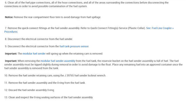

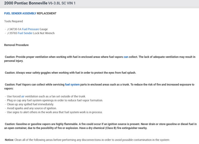

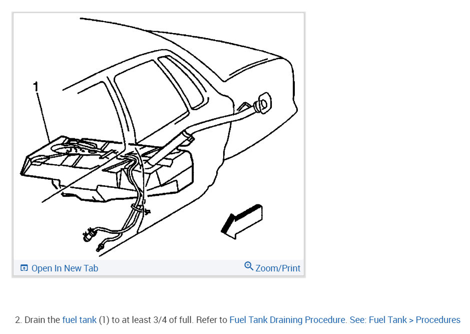

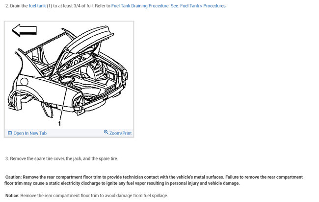

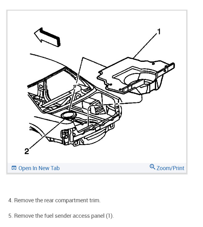

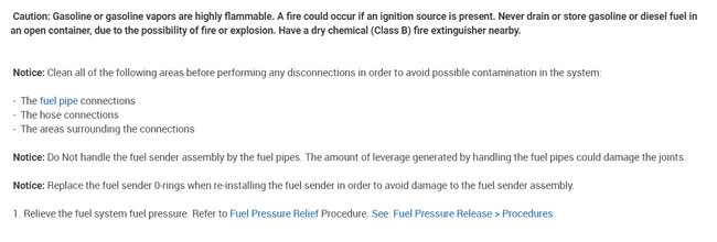

  • 55,423 POSTS

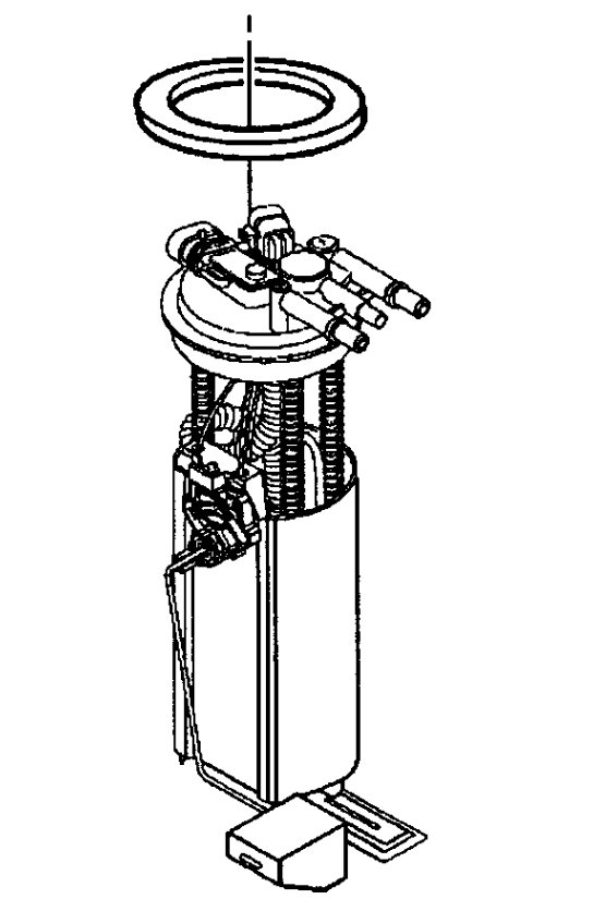

Those compression readings are a little low, did you use OEM sprak plugs? (it makes a difference) Also the fuel pressure is a little low as well which can be the problem. It should be:
Key ON, Engine OFF 48-55 psi
Engine Running Pressure Drop 3-10 psi
I would replace the fuel pump. here is a guide to help walk you through the steps with diagrams below to show you how on your car. You will need to drain the tank.
https://www.2carpros.com/articles/how-to-replace-an-electric-fuel-pump
and
https://youtu.be/Q5MH2gnyFH0
