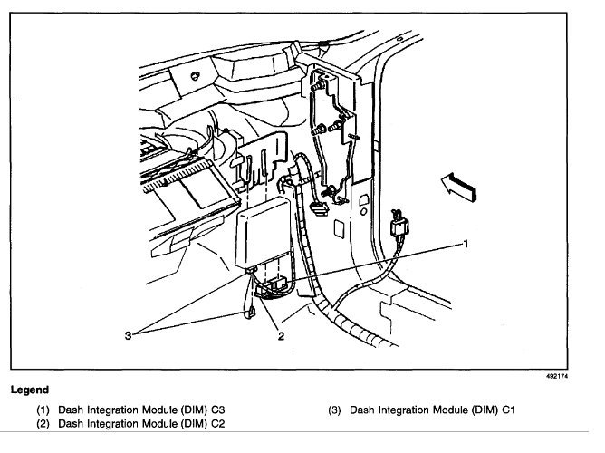

WHERE IS THE BODY CONTROL MODULE LOCATED ON THIS CAR?
Feb 1, 2010 at 3:29 PM
  • 54,854 POSTS
Hey Fred,
It is located on the passengers side near the kick panel, here is a diagram to show you.
Please let me know if you need anything else to get the problem fixed.
Best, Ken

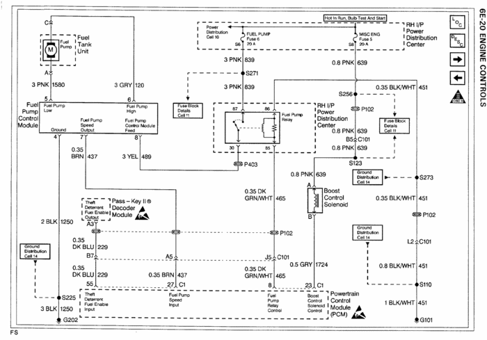

car wont turn over security light is flashing, been this way for a week as i have searched and searched for solutions on fixing this problem but nop one can tell me where it is or what it looks like

Not sure why you are even looking for the BCM since it plays no part in the VTD system on this car.

OMG, your kidding, it has nothing to do with the security system? I was told if I bypass the purple/wht wire # B7 and the wht/blk #B8 and put a risistor in between these two wires it would satisfy the security system and the car would start. So your telling me for a week I have done things that was not neccesary? Please tell me where to go to fix this problem I am tired of walking 9 miles each way to work I start at 10 pm get off between 7 and 8 am I cannot do this any more..

The 2 wires that you are looking for are right at the ignition switch. You can access them by removing the cover around the column. You can't use just any resister. you have to measure the pellet in the key and duplicate it. Just remember that the only thing that you are bypassing is the key sensor and the rest of the system has to remain operational or it still won't start. this is only going to work if the key sensor is the problem in the first place.

My key has a resistance of .681 ohms, do you know what it should be?

Yes, that is one of 15 possible resistance values they use. They are different so keys don't interchange. You can go a maximum of 30ohms plus or minus.

I have a 1996 Pontiac Bonneville which runs great but quits sporadically and wont restart you cant here the fuel pump running. Have checked and cleaned all grounds battery cables and fuses. the security light acts normal. sometimes it will start in a couple of hours sometimes days???

If you can't hear the fuel pump -check and test the fuel pump fuse no.6, FP relay and the computer control of the fuel pump relay coil side

You need a single resister of 681ohms. What does 10, 15 or 22 have to do with anything?
