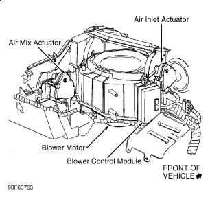

I have replaced my blower motor, and still not blowing air. I have a switch that you just turn to control the fan. I do not have climate control. Can you please help? Thanks, Cathy

Cathy: When you replaced the motor, was there power to it? Also, there is a module you need to check for power. Here is a picture of it.
https://images.2carpros.com/forum/automotive_pictures/249084_blower_1.jpg
