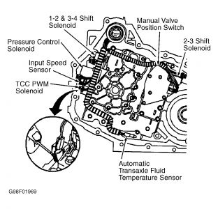

Trying to change torque converter clutch selenoid and can't find it. I pulled the side plate on transmission and its not on the transaxle. cAN YOU HELP

Need to remove pan drain fluid remove filter TCC inside. Check out the diagrams (Below). Please let us know if you need anything else to get the problem fixed.trans
