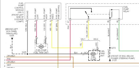

Electrical problem
1999 Pontiac Bonneville 6 cyl Front Wheel Drive Automatic 10000+ miles
would like a electrical digram of fuel sys to understand wireing componets. the pump works with a direct hot wire but inop through system. have any ideas? if i can fix this maybe i can get to wk. more often & afford the donate? HELP
Nov 6, 2010 at 1:22 PM
JDL
  • 16,098 POSTS
The wiring diagram is below. The vin 1 has the conrol module, the vin K doesn't. If you have any questions, holler.
