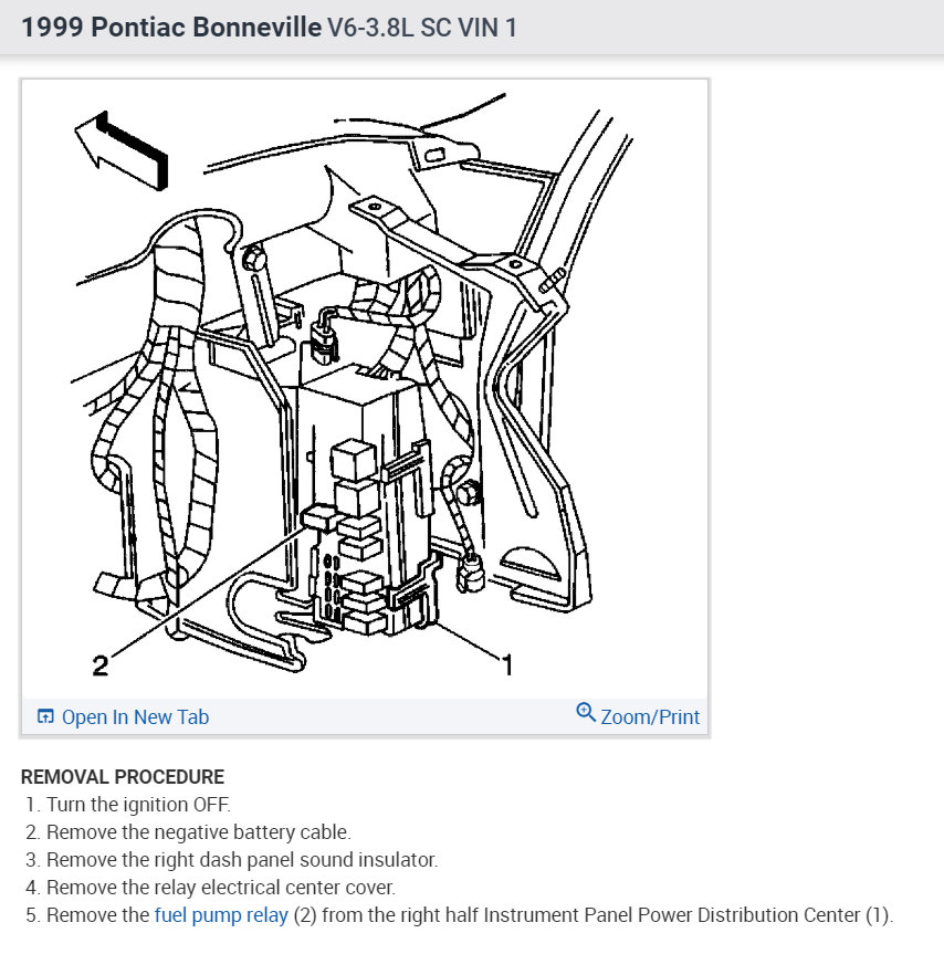

Is it hard to change this fuel pump do I need to remove exhaust what would a typical quote from an auto shop be? I need to know where the fuel pump relay is as well?
Friday, February 12th, 2010 AT 1:06 PM
22 Replies
BLUELIGHTNIN6
  • 16,542 POSTS
Here is a guide to help test he relay with the relay location in the diagrams below.

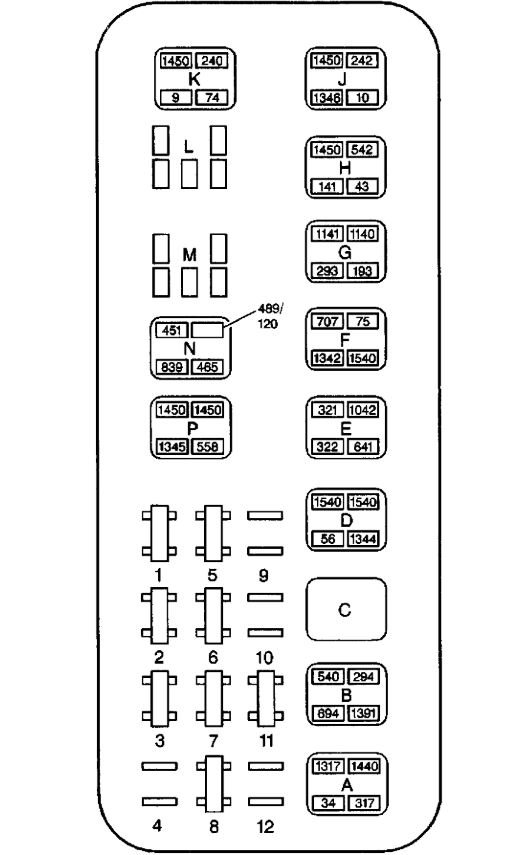

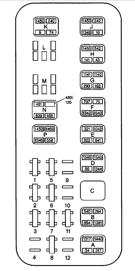

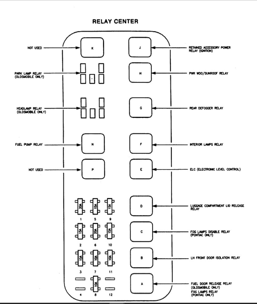

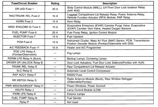

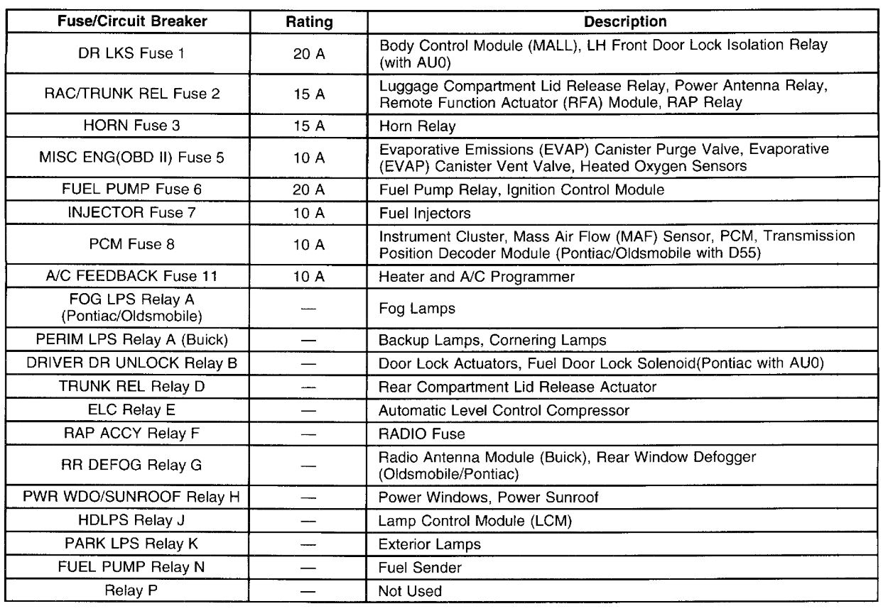

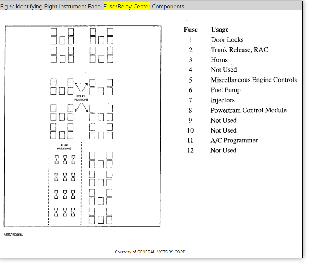

There are 4 relays in my 1999 pontiac bonneville under the hood. Which one is my fuel pump relay?
+2
Monday, July 13th, 2020 AT 5:57 PM (Merged)

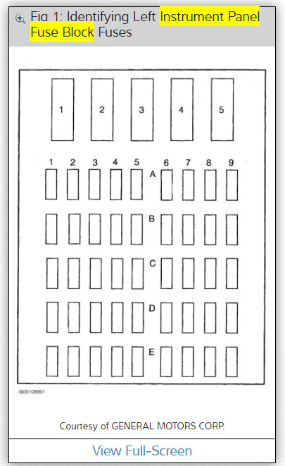

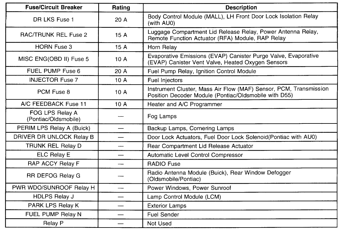

SUSMAN28888
  • 62 POSTS
It is relay "N" it is powered by fuse 6... They are located in the R/H instrument panel fuse/relay block
See the guide below on relay testing to help troubleshoot the problem
The fuse/relay block diagrams are attached below,
let us know if you need anything else

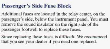

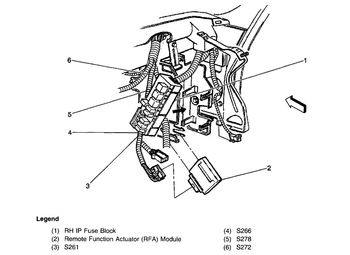

I am wondering where the fuel pump relay is located on a 1997 Pontiac Bonneville? Can someone please let me know? Thank you
+2
Monday, July 13th, 2020 AT 5:59 PM (Merged)
JDL
  • 16,098 POSTS
My info says right i/p power distribution center.
I came across this in your owners manual.
https://www.2carpros.com/forum/automotive_pictures/170934_relay_center_1.jpg
+3

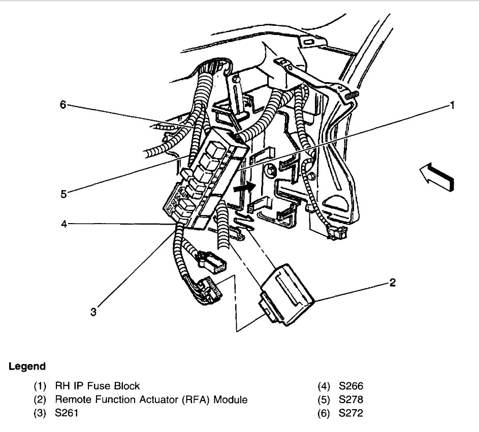

HEATHER7322
  • 1996 PONTIAC BONNEVILLE
Other Category problem Engine Size unknown Front Wheel Drive Automatic 100000 miles
Where is the fuel pump relay located on a 96 bonneville
  • 75,992 POSTS
Its behind the right side of dash, on dash fuse panel.
Here is a guide to help you test it
Cheers
-1

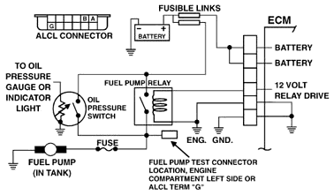

HEATHER7322
I just replaced the fuel pump syphon anf filter and it's not getting any juice to it and my car won't start tested it and the wiring is fine but the pump won't kick on
+2
  • 75,992 POSTS
The relay comes On only for 2secs-get a helper for the key and recheck the gray wire for battery voltage. See below
https://www.2carpros.com/forum/automotive_pictures/12900_oil_sending_unit_and_fuel_pump_circuit_24.gif
+4

HEATHER7322
I am not a certified mechanic so I'm not sure what the key is exactly maybe you could be more specific
MELARONJAKE
  • 1995 PONTIAC BONNEVILLE
I have engine light on, loss of power up hill hesitation and shuttering while driving, idles fine, good temp n oil pressure is it the fuel pump relay? My fuel pump comes on when ignition is on, Also this problem has occured in the past but not as bad engine light didnt stay on and seemed to go away. I do have the slightest leak in intake manifold gasket but water doesnt even make it to ground and idles great. Hasnt stalled on me, If vehicle is not allowed to warm up going in reverse out of driveway gives loss of power. The loss of power shuttering n engine light happened at end of 200 mile journey ran the tank low filled up drove about 90 miles.
  • 75,992 POSTS
I mean have a helper to turn key to On while you are down there at the fuel pump connector checking for power all you got is 2secs. On that power then it disappear. Do you understand? If not come on back
+1
