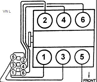

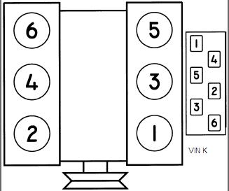

I have a 1996 pontiac bonneville and I tried to change the spark plugs but I don't think I put the firing wires back in order. Can you please give me a visual of how they are suppose to go back from the cap to the engine.

https://images.2carpros.com/forum/automotive_pictures/170934_vin_K_1.jpg
Notice the vin letter.
https://images.2carpros.com/forum/automotive_pictures/170934_vin_L_1.jpg
