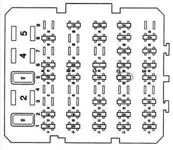

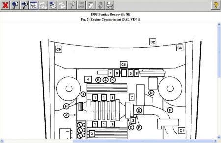

Could you please tell me the location of the blower motor relay and if there is a number for the location on one of the fuse panels?

The blower motor relay is located center rear of engine compartment below right maxi fuse block see no. 7 below-the fuse you're looking for is the AC fuse 30amp it powers the blower motor relay/motor itself
https://images.2carpros.com/forum/automotive_pictures/12900_relay_24.jpg

https://images.2carpros.com/forum/automotive_pictures/170934_pontiac_fuse_box_1.jpg
instrument panel fuse box, check the one with the circle. The circuit may go hot when you turn on the key, use a testlite on the circuit. The relay should be underhood center, rear, check the firewall. Also check ac fuse, my info says 30 amp, the fuse block for that should be under the passenger side dash. the previous fuse block is under driverside dash.
