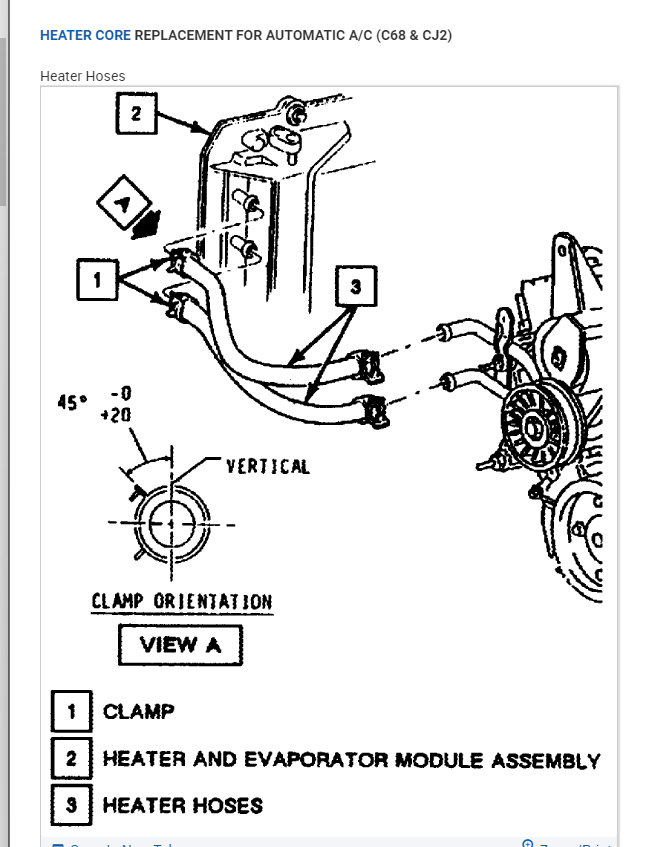

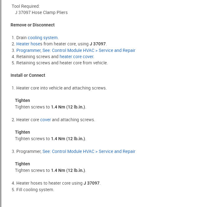

Heater core is leaking out on the passenger side floor board. My question is how do you access the heater core to change it. I have taken off the cover underneath the glove compartment. But there are wires connected to the heater vent, and I was afraid to mess with it until I got some good advise. Can you help me?
May 4, 2010 at 2:18 AM
No problem. Here are some guides that will help with this.
These are different vehicles, but they will give good info that will be helpful.
https://www.2carpros.com/articles/replace-heater-core
Below you will find the info from the manual that will give the additional details needed.
Please run through this and let me know if you have other questions.
