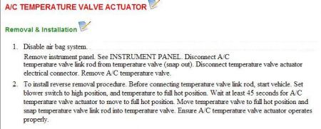

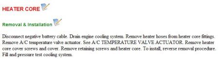

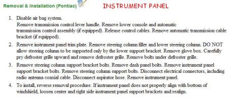

does the dash have to be removed to replace the heater core or can it be done by removing a couple of covers
