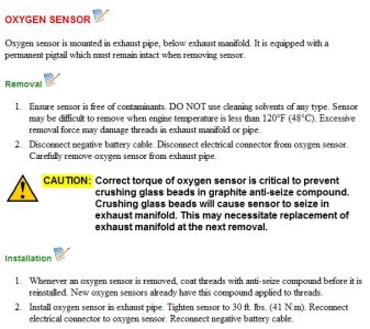

I have to replace my oxygen sensor in my car. The problem sensor is on engine portion and I heard that replacing the sensor could be problematic. Can you tell me where the oxygen sensor is located on this vehicle and if you have any tips on replacing them without problems.

so long as its replaced correctly there should be no problems from it...oxygen sensors should be replaced on a regular interval like any other tune-up equipment is..
